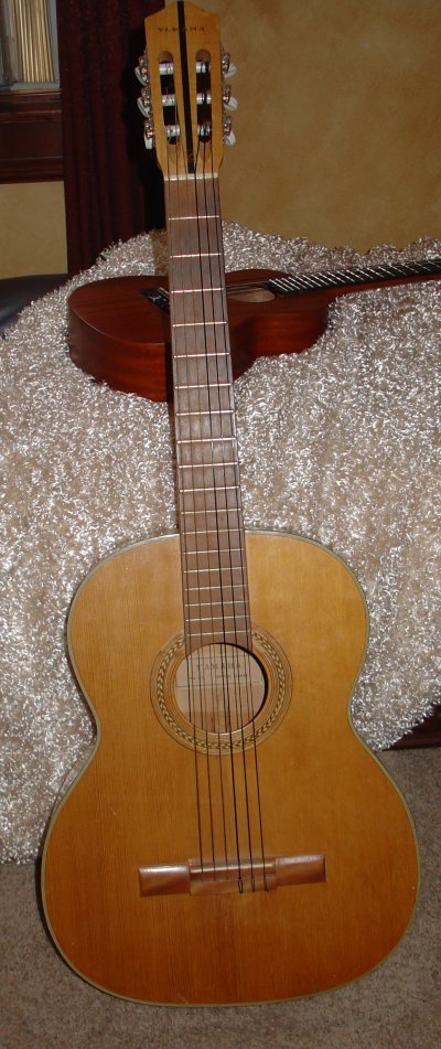

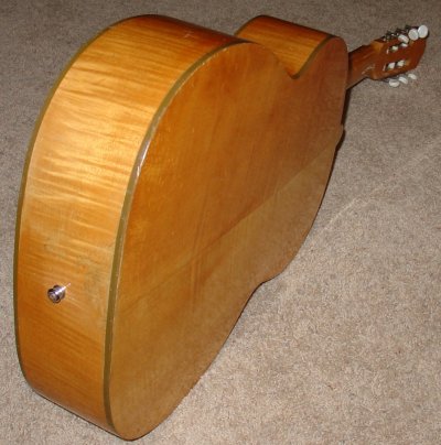

Here are some pics.

Offtopic, but that is one weird plantilla they used.  Is the maple laminated? The rosette is neat.

It does have an unusual shape. I haven't checked for laminated wood yet, I thought I clean it up and take a look inside this weekend. Unfortunately the rosette has some damage on both sides of the neck. You can see the missing wood if you look closely.

Looks like a student guitar that the student wasn't very interested in playing. Though the pictures don't show what kind of action (or belly) it has, it looks to be in great shape for being 50 years old. Looks to be inlaid herringbone with a sticker around it that's now starting to come off.
What's up with the bass strings? How do they anchor to the bridge?

The base strings are just threaded through like a steel string would be if it were put on the guitar... ie. these nylon base strings have the little nubbin on the end like a steel string does. There is a channel where the rosette parts are missing, so I don't think they are stick-ons?

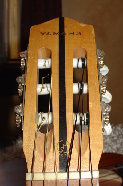

Well, as it turns out, this is a keeper. I have been trying to glean info from different sources and finally, with the help of others, found a sneaky fellow over at the larrivee forum. Apparently this model was made in Japan, and was the first classical under the Yamaha name. There were other earlier models named 'Dynamic' by Yamaha. This was also the first of the Yamaha's exported to the west ...ern hemisphere. The little JIS 9202 logo on the headstock indicates that this one was probably made in 1963. It has a solid spruce top and solid flamed maple sides and back. Maple neck with mahogany fretboard. The rosette is inlayed wood as well. Apparently this particular model is very rare, which, doesn't mean much to the value since it is not a martin.

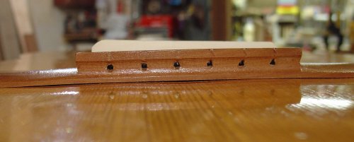

So I had thought about just cleaning it up, restringing it and playing away. I found that the three base strings on it were actually steel strings. This caused some issues:
So I have got to remove and reglue the bridge. In addition, it appears to have had some fretwork done.

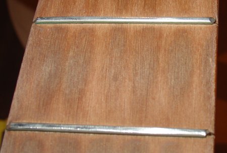

You can see how the frets have been file flat on the left side. This flattening extends from the first fret up to around the tenth.
Also notice that the frets do not extend to the edge of the fretboard. This is weird. Isn't it usually the other way around?
Another issue, or non-issue?, is that there is relief in the neck. If I remove the frets. Do I clamp the neck straight, sand flat, refret, check them for even height, clean them up and then let the neck spring back? Or, am I looking at a much more sinister task... remove its neck!
